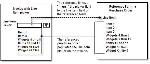

Primavera Unifier populates the data in some pickers with a reference process form. Reference processes are necessary for any form that uses BP or line item pickers. Primavera Unifier users use these pickers to call data from another—a referenced—business process. The reference establishes a link between the records (for example, an invoice record to a purchase order). Because of this link, record to record, you can populate one form with data from other forms.
To make these pickers effective, you must connect both forms by "mapping" a field on the picker to one on the referenced form. In operation, the picker will point to the referenced form and use the values in the fields you specify to display data on the picker. Once the reference link is created, you can use the referenced form to populate any data elements that the referenced and current form have in common.
Likewise, if a form includes a line item picker, the user can select specific line items from a referenced form. To make a line item picker effective, you must specify what line items the user can select from the referenced form. Once you do this, the referenced line items will automatically populate those line item fields that the referenced and the current form have in common.

Select the checkbox to display the field name as a hyperlink. Users can use this hyperlink to open the referenced form from the detail form you are designing. For example, if an invoice references a purchase order contract, the name of the referenced purchase order will appear as a hyperlink on the invoice form and allow users to open the PO record.
Allow Line Item Referencing
Select the checkbox to allow users to refer to specific line items on a detail form.
For Destination Element, select the data element (line item) you want to populate. The list displays the fields on the upper or detail form you are designing.
For Source Element, select the field in the referenced form. The value in this field will populate the line item field on the form you are designing. The list displays the fields on the upper or detail form you are referencing.
