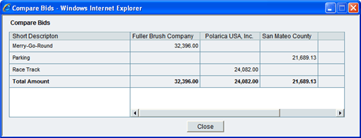

For the Request for Bid (RFB) business process, Primavera Unifier includes an bid tabulation feature. This feature provides a default comparison sheet with which Primavera Unifier users can compare the bids they receive from vendors.
The default bid comparison sheet (shown above) shows only the bid dollar amounts for each line item for which the vendor submitted a bid.

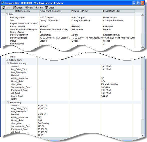

Alternatively, you can design a custom bid tabulation sheet in uDesigner that can include more information in a layout specific to your company’s needs. Using a custom bid comparison sheet, you can compare vendors on criteria besides price, such as certifications and re-negotiated line item prices. You could also add comments to the submitted bid that can be displayed on the bid tabulation. This sheet becomes part of the RFB process in Primavera Unifier; users can view this sheet from the RFB when the bidding has ended.
Note: You can design only one custom bid comparison sheet for your company.
To design the bid comparison sheet, you will create upper and detail forms, as you would any business process. You must design the bidder form first, as uDesigner automatically enters the fields from this form on the sheet design. In addition, you can add other elements to the design from the Custom Data Elements list.
Note: The bid comparison sheet must match the upper and detail forms of the bidder’s BP. When you create the design for the sheet, uDesigner automatically adds the data elements from these forms. If you later add or remove an element from the bidder forms, you will also have to add or remove it from the sheet.
Example of a custom bid comparison sheet:
The custom-designed bid comparison sheet shows the following:
