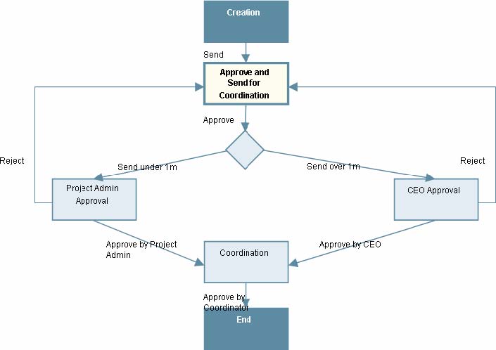

A workflow can contain a conditional step that must be resolved before the workflow can continue. Conditional steps entail separate (conditional) routing. This routing is triggered at the step by a field condition or situation you can specify in uDesigner. An example of conditional routing is a purchase order that follows one path through a workflow if the total amount is less than a certain amount, and follows another path if it is equal to or greater than that amount. (The trigger value for the field on the conditional step’s form is assigned when the business process is set up in Primavera Unifier.)

  1. In the Workflow Designer window, click the Condition button.
  2. Click on the canvas. The conditional step appears as a diamond shape.
    You can include multiple conditional routings in a workflow, but only one condition per step.

  5. Connect the conditional step to other steps as appropriate.
    A conditional step must have one incoming connector and two outgoing connectors.
  6. Denote the links as conditional:
    1. Double-click the line or elbow connecting the conditional step (the diamond) to another conditional step. The Conditional Properties window opens.
    2. In the Conditional Name field, enter a name for the action of the conditional link; for example, "Under 1 Million" to route an invoice approval to one authorizer, or "Over 1 Million" to route it to another authorizer.
