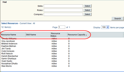

    Unifier populates most pickers with the records that you see in the logs and uses the layout of the headings on the logs for the layout of the picker. These logs show the records that were created, for the most part, with attribute forms.
Log created for the Resource Manager:
Resource picker on a business process uses the log headings and the Find fields that were specified when the log was created:
