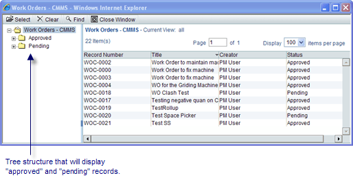

Some pickers can be designed to display a by structure to guide you to the correct location where a record resides, such as a specific project or a specific business process. Below is a list of Work Order business process records that have been designed to show an additional navigation column on the left.
By using this additional tree structure column, you can navigate more easily through your business process records to the one you want. The Cost Control base product uses the following pickers:
