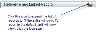

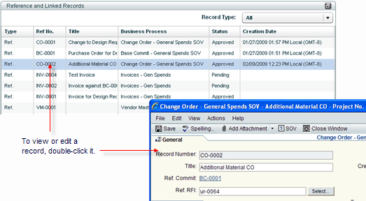

You can enlarge this half of the window by placing the cursor between the two windows and dragging the cursor left. You can also use the expand icon on the title bar:

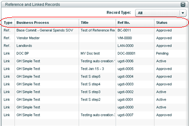

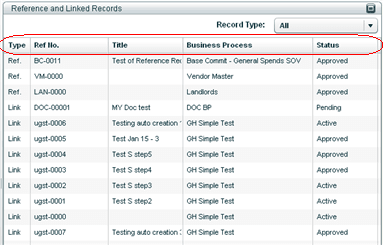

To present the information in a way that is more convenient to you, you can rearrange the columns of the list by dragging them left or right.
The list of records shows the following information:
This column
Displays this
Type
Displays Ref. if the record is
Referred to by the original record you opened, or
Referring to the original record you opened
Displays Link if the record is linked to the original record via the Linked Record feature.
Displays Link to Line if the record is linked to a line item on another business process.
Note: If the record is both a referenced record and a linked record, Unifier will show it as a referenced ("Ref.") record, not a linked record.
Ref No.
Displays the number of the record.
Title
Displays the title of the record.
Business Process
Displays the name of the business process to which the record belongs.
Status
Displays the status of the record. Records in a terminal status will also appear on this list.
Description
For links to line items on a record, this column displays the line number, the short description of the line item, and the tab. For line items from a Document type BP, the column shows the name of the line item.
Creation Date
Displays the date the record was created.

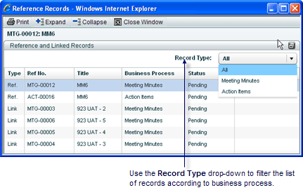

From the Reference and Linked Records list, you can open a record and view it. In addition, if you have permissions, you can edit and take action on the record the same way you would by opening the record directly from a Unifier log. When you finish the edits and close the form, Unifier will return to the Reference and Linked Records window. The records you can edit must be at the same level as the focused record. If the referenced record that you open from the list resides at another level (such as in a different shell, project, or at the company level), you will not be able to edit it; it will open in view mode only, regardless of your permissions.
Contrary to the graph, you can also open and view or edit linked records (if you have permissions).

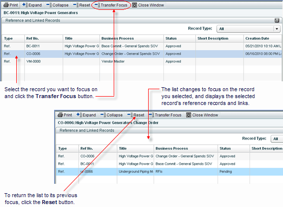

A few things:
You can change the focus of the list to another record and display all of its referencing records. In addition, the graph will change accordingly. You cannot transfer the focus to linked records; only referenced records.
The new focus of the graph will display five levels of records:
