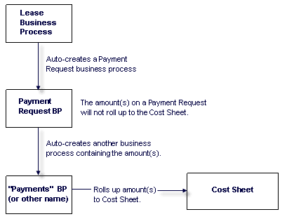

Note: You receive a single auto-created line item based on the defined grouping criteria.
For cost purposes, these invoices/payment requests do not roll up amounts to the Cost Sheet. To roll up these amounts, the invoice/payment request should, in turn, auto-create another business process for the purpose of rolling up the amount(s) to the Cost Sheet.
