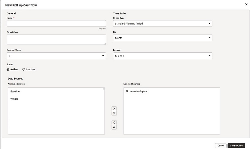

  5. From the toolbar options, click Create to expand the menu and click Roll up Cashflow to open the New Roll up Cashflow window, as shown below.
  6. Proceed to complete the fields in the New Roll up Cashflow window.
    The Data Sources block lists the available sources for you to select.
  7. When finished, click Save & Close. to add the new Roll up Curve to the Cash Flow log.
