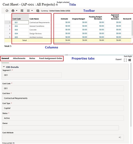

  4. From the first column, identify the project or shell that you want to access, and click in the cell (click on the link) to open the cost sheet for that project or shell in a window.
As shown in the image below, the cost sheet window has the following parts:
The following explains the elements of project or shell cost sheet when you access it from the company cost sheet.
