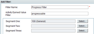

  3. Click Add. The Add Filter window opens.
  4. Complete the Add Filter form.
    The activity earned value filter uses an "and" condition. This means that it will display all activities associated with the CBS codes selected, but will display a BCWS value only for those activities with a text entry in the Activity Earned Value Filter column that matches the text entry in the filter.
  5. Click OK to save and close the form.

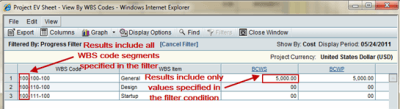

  1. Click the Filters icon. The Setup Filters window opens.
  2. Select the filter you want to use and click Apply Filter.
    The filtered EV sheet will display:
    • All the CBS codes specified in the filter
    • Only the values that are specified in the filter
  3. To restore all the rows to the EV sheet, click [Cancel Filter].
