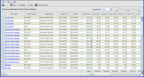

In the company-level or project-level Resource Sheets log, select Resource Allocations Sheet and click Open.
Company-level resource allocation sheet
Column
Description
Role Name
Allocations are shown for each role against one or more projects. The combination of role and project is always unique. The Role Name column is sorted alphabetically. Clicking on the role name will open the Role properties window in view-only mode.
Project Number
The project number of the allocation. This is displayed in the company-level sheet only.
Project Name
The name of the project. This is displayed in the company-level sheet only.
Date From
Displays the earliest date that has a non-zero allocation for the role.
Date To
Displays the latest date that has a non-zero allocation for the role.
Total Hours
Displays the sum of hours allocated to the role, This field is displayed only in hours view.
