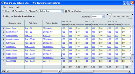

Booking vs. Actuals summary sheet
At both the company level and project/shell level, you can use this sheet to see booking information versus actual time usage against a project or shell.
To view the Booking vs. Actuals summary sheet
  1. In the company-level or project-level Resource Sheets log, select Bookings vs. Actuals Summary Sheet and click Open. Unifier displays a Properties window.
  2. In the Properties window, specify the time sheet business process that should roll up values to the Booking vs. Actuals Sheet.
  3. Click OK.
Unifier uses the values on the time sheet business process you specified to calculate the data on the Booking vs. Actuals summary.
The sheet shows all booked resources, along with their roles and the projects/shells they are booked in. It shows both the booked hours and the actual hours the resources worked on the project/shell. The sheet does not show non-project hours.
To see details
To see a resource’s booking details, click the hyperlinked hours in the Booked column. Unifier opens a Cell Detail window showing the booking details for the resource. To see details on a resource’s actual hours worked, click the hyperlinked hours in the Actuals column. Unifier opens a Cell Detail window showing the actuals for the resource.
