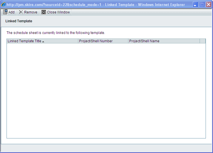

To view the linked template for a linked schedule sheet
  1. Navigate to the schedule sheet log.
  2. Select a schedule sheet that is linked to a schedule sheet template.
  3. Choose View > Linked Template. The Linked Template window opens.
  4. Click Close Window when you are done viewing the linked templates.
To link existing schedule sheets to a link-enabled template
You can link an existing schedule sheet to a link-enabled template. Linking an existing schedule sheet causes loss of existing data on the project or shell schedule sheet, including all activities, columns and cell data. Project or shell schedule sheet properties, including the Schedule Start Date are retained.
  2. Select a schedule sheet that you want to link to a schedule sheet template.
  4. Click Add. The Schedule Sheet Templates window opens.
  5. Select a template and click Select.
  6. Click OK on the confirmation message that data in the newly-linked sheet will be modified when the update is completed using the link between the template and the sheet.
  7. Click OK.
To unlink schedule sheets from a link-enabled template
Unlinking removes the link between the schedule sheet and the template so no further updates can occur from the template.
  4. Click Remove.
  5. Select the template.
  6. Click OK.
