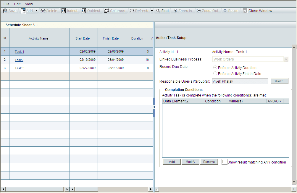

  4. Choose File > Setup Scope Management. The Activity Task Setup window displays on the right side of the pane, replacing the view of the Gantt portion of the window.
    Note: You can return to the Gantt chart view by clicking the Gantt button.
    Activity Task Setup example window
  5. Complete the Activity Task Setup portion of the window as described in the table below.
  6. Repeat these steps for each activity.
  7. Click the Save button when your changes are complete.
