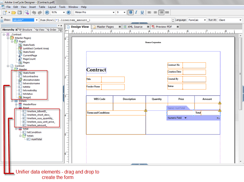

  11. Click Finish. The XSD tags appear in the Data View tab on the left pane of LiveCycle.
    Note: The tag naming scheme is a combination of LiveCycle and Unifier names. The first word before the underscore is LiveCycle’s term, for example, "task," "form," and "lineitem." Everything after the first underscore is a Unifier data element. For a full list of the Unifier data elements definitions (XSD tags), see "XSD tags used in creating a PDF template" below.

From the XSD tag list in the Data View tab on the left pane of LiveCycle and drag and drop your tags onto the template. For Attachments, Comments, Tabs and Workflow tags, special care needs to be made to ensure that the tags do not overlap in the printed output.

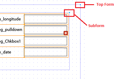

  1. Select an Attachment, Comment, Tab or Workflow tag and drag and drop it onto the template, for example, "Attachments." The XSD tags display as a group inside a frame ("subform") with four small squares at each corner of the frame. The subform frame rests inside a frame called "top form."
  2. Right-click on the subform’s frame corner and choose Palette > Objects. The Object tab opens on the right side of the LiveCycle window.
  3. In the Content field, select Flowed.
  4. Right-click on the top form’s frame corner and choose Palette > Objects.
  5. In the Content field of the Object tab, select Positioned.
