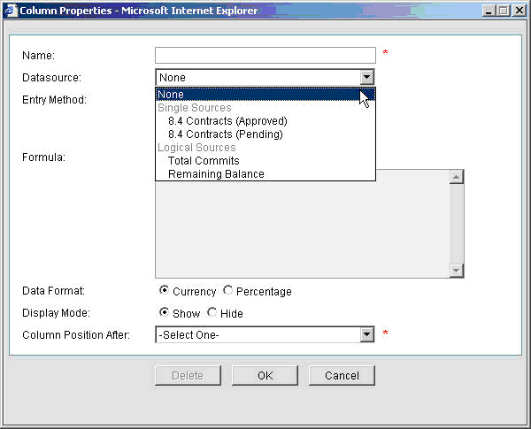

  5. You may add additional columns as needed. Click Columns, then click New. Complete the Column Properties. The data source choices for columns include:
    • Single source: All active cost BPs for your company (and their statuses), regardless of project. You determine which statuses you want to appear on the sheet. If you import and set up cost BPs that might reference the blanket PO, be sure to add them to the summary sheet template to track them against the total.
    • Logical source: Total commits and remaining balance. These should be set up as formulas, where total commits is the sum of the commits that you added as columns, and the remaining balance is the difference between the original amount and total commits.
To enable validation, include a total commits column to keep track of commit BPs that reference the blanket PO, and a remaining balance column to ensure that you do not exceed the original amount.
