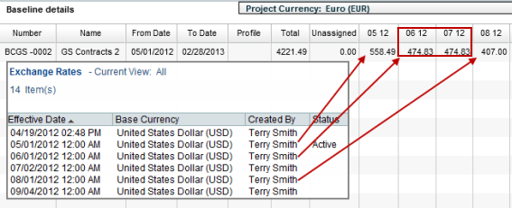

Future currency exchange rates
Future exchange rates allow you to plan ahead for currency fluctuations. Unifier uses the active exchange rate based on the effective date; however, cash flow curves show currency rate changes at the beginning of the first full month the rate is in effect.
In the Baseline details example that follows, you can see differences in values due to future exchange rate conversions.
Additional information
For Cost transactions, the exchange rate used is based on the latest update date of the BP record.
The uuu_effective_date is not used for determining the rate to be used on a BP Record.
