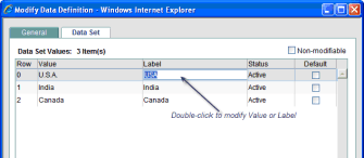

To edit a data set value
  1. Open a Data Definition and click the Data Set tab.
  2. Double-click the value or label to modify. The field becomes editable. Edit the field as needed and click OK.

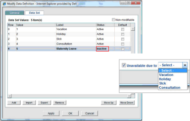

To activate or deactivate a data set value
  2. Click the Status pull-down menu and choose Active to activate, or Inactive to deactivate. Click OK.
    Inactive values do not appear on the list at runtime.
Active and Inactive data set values
