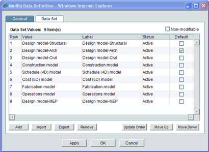

Example of row numbers before sorting:

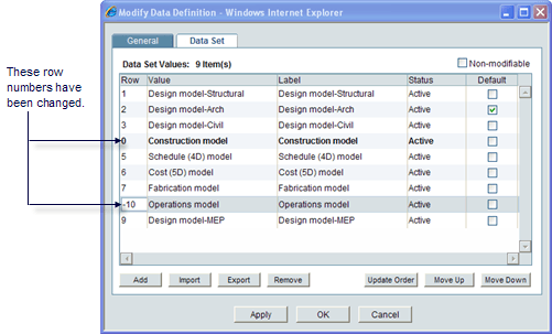

Edited row numbers:

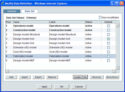

Row numbers after sorting:
