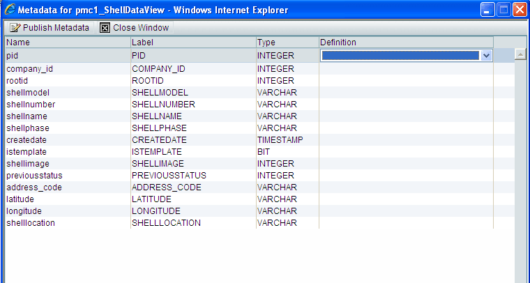

To publish metadata
You can associate metadata with its Unifier data set for both labels and values. Data views tend to contain technical shorthand from system and SQL abbreviations. While clear to the technical person who wrote the data view, report consumers will appreciate seeing the same field labels and field value selections they see in their business processes and managers.
For example, in your data view you might include the data element "year_pd," which represents a pull down menu with selections for different years assigned to its data set. In your user-defined report, you might want to see the label "Year" instead of "year_pd;" and you might want to query on meaningful values, such as 1999, 2001, 2002, etc., instead of the numeric values of the data definition, 1,2,3, etc.
  1. In the User-Defined Data Views log, select a published Data View.
  2. Click the Metadata button.
  3. Double-click in the Definition field for each data element and select the data definition for the selected element. The data definitions available for selection are filtered by the data elements used.
  4. Double-click the Label field for each element you want to use in the UDR. Rename it to whatever you want to see in the report.
  5. Click Publish Metadata.
