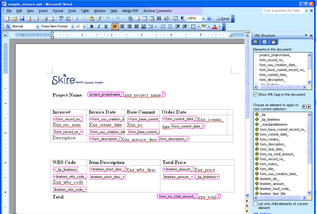

  10. Click OK. An MS Word document opens with a list of available Unifier BP tags under "XML Structure" on the right side of the window.
  11. To add XML tags to the Word document, enter text (e.g., xxx_project_name to print Project Name) and click the project_name tag that is available as part of the XML structure.
    Note: For custom print to work properly, do not add XML tags to the header and footer.
    The text will be surrounded with project_name tag. You can follow this process for any element.
  12. To print line item information, select the text for all the line item elements and select the appropriate XML tags. Then select all the elements that are part of the line items and click the _bp_lineitems tag.
    By doing this you are enclosing all line item elements within the _bp_lineitems XML tag. At runtime, Unifier will know that the elements that are part of _bp_lineitems should be printed for each line item of the business process. Elements that are part of the upper form are prefixed with "form_", and detail form elements are prefixed with "lineitem_".
  13. Turn off the XML tags before saving.
  14. Click File > Save As. Name the document, and select XML format for the save option. The document must be saved in XML format. Now you are ready to upload the completed document through the Business Process Configuration window.
