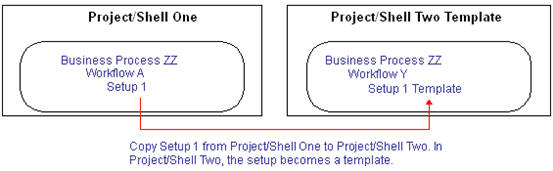

In this copy action, you copy a workflow setup from a business process in a project or shell and make it a template in the BP you copy the setup into.

  6. Click the Copy From button and choose Project/Shell.
    A copy window opens, listing all the workflow setups for that BP that exist in all the projects and shells in your environment.
  7. Select the setup you want to copy and click Copy. The Workflow Setup window opens.

Unifier makes a template of the setup you copied and adds the template to the workflow setup log. If you made the setup Active, Unifier will perform an error check on the new schema and notify you of any errors it encounters; otherwise, the error check will not occur until the setup is activated.
