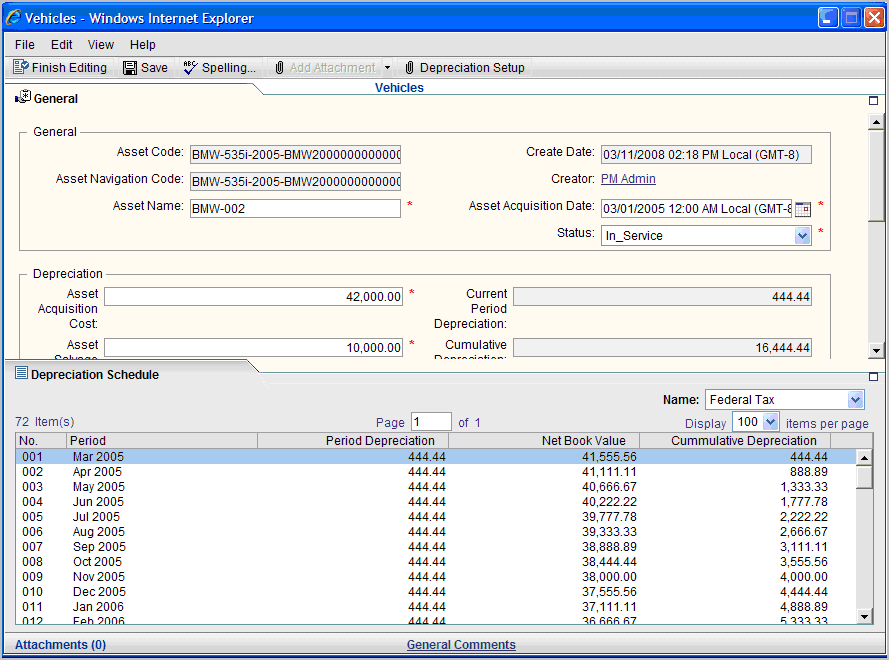

Depreciation schedule columns are predefined. Columns are populated based on the depreciation calculation. Below is a sample depreciation schedule.

  4. Click the Depreciation Setup button. The Depreciation Setup window opens.
  5. Add a row by clicking the Add Row button.
  6. Complete the information for the depreciation setup as described in the table below.
  7. Click OK to save and exit the window.
  8. When the asset template is complete, click Finish Editing.
