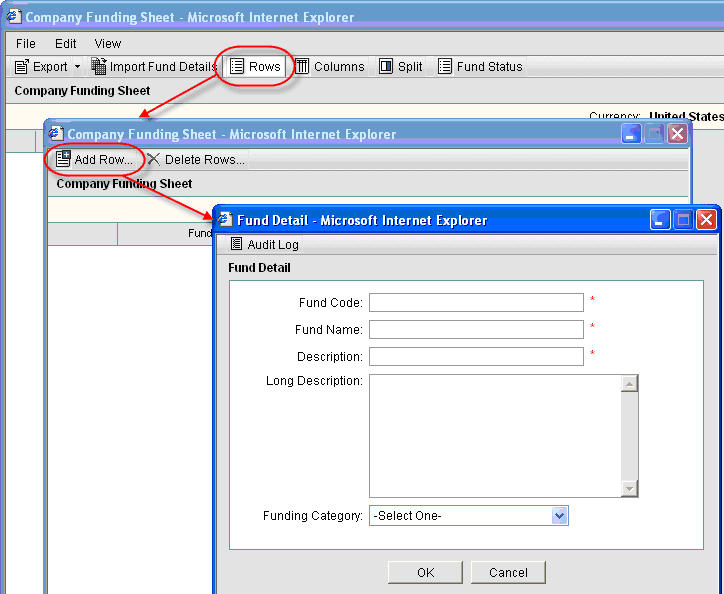

  1. From the Company Funding Sheet, click Rows.
  2. Click Add Row. The Fund Details window opens. If you have imported a Fund Attribute form, this will be displayed as the Fund Details window.
  3. Complete the Fund Details window.
    The table below describes the fields on the default Fund Details window. If your company has imported a Fund Attribute form, the fields you see may differ greatly.
  4. Click OK. The fund appears as a row on the Funding Sheet in alphabetical order.
