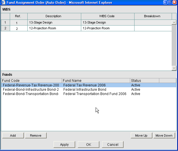

  2. Click the Fund Assignment button on the toolbar. The Fund Assignment window opens.
    You can set Fund Order or Fund Ratio. This is dependent upon the Assignment Rule that you choose for spend under the Project/Shell Funding Sheet > Properties > Assignment Tab.
  3. Select a CBS code from the upper pane.
  4. Select a fund from the list and click OK.
    The bottom pane will also display assignment status of funds. You can modify assignment status of a fund from Project Funding Sheet > Fund Assignment Order window. Funds with Inactive status will not be used as part of consumption process.
  5. Select a fund and click Move Up or Move Down button to change fund order.
  6. If you have defined Breakdowns for a CBS code, then select breakdown to view funds.
  7. To add a fund, click the Add button. The Add Funds window lists the funds that are available for the selected CBS Code. Select a fund from the list and click OK.

  2. Click the Fund Assignment button on the toolbar. The Fund Assignment Order window opens.
  3. You can set Fund Order or Fund Ratio. This is dependent upon the Assignment Rule that you choose for spend under Project/Shell Funding Sheet > Properties > Assignment Tab.
  4. Select a CBS code from the upper pane. A list of funds that are available for this CBS will be displayed on the bottom pane.
