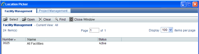

The Location Picker opens when you click the Location Select button. This is an example of a Location picker:
In this example there are two single instance shells, Facility Management and Project Management. You can use this Location picker to select a shell instance. The multiple instance shells are listed under the single shell instances that are represented as tabs. You can select a tab on which the shell is listed on the organization configuration.
When this picker is opened first it displays the instance of single shell. In this example it is showing All Facilities. If Project Management tab is clicked then you should see the single instance shell created under that tab. You can now select this instance by highlighting it and clicking the Select button. If you want to drill down to another shell instance which is created under this single shell instance, you can navigate to it by selecting the single instance shell and double clicking or selecting a shell and clicking the Open button.
