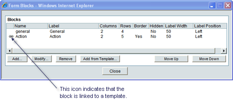

  4. On the Form Designer window, click the Blocks button. The Form Blocks window opens.
  5. Click the Add from Template button. The Upper Form Templates window opens, showing a list of the templates available for this business process.
  6. Select the template you want to use and click the Select button.
    uDesigner adds the template block(s) to the bottom of the design and links the form to the template.
  7. On the Form Blocks window, click Close.
