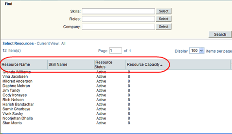

    Unifier populates most pickers with the records that you see in the logs and uses the layout of the headings on the logs for the layout of the picker. These logs show the records that were created, for the most part, with attribute forms.
Log created for the Resource Manager:
Resource picker on a business process uses the log headings and the Find fields that were specified when the log was created:

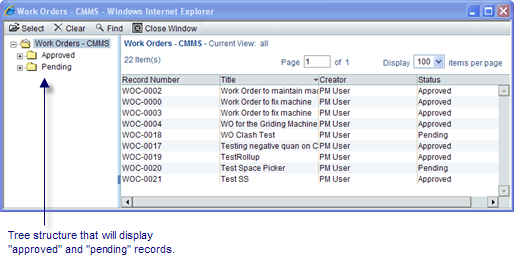

You can create a picker log for work order records that could be displayed by their status, such as "pending," or "complete."
A standard log shows only a flat list of all the records:
A picker log displays a tree structure where users can drill down to more specific records:
In general, the only difference between a standard log and a picker log is that the picker log includes a grouping structure, but the standard log does not.
