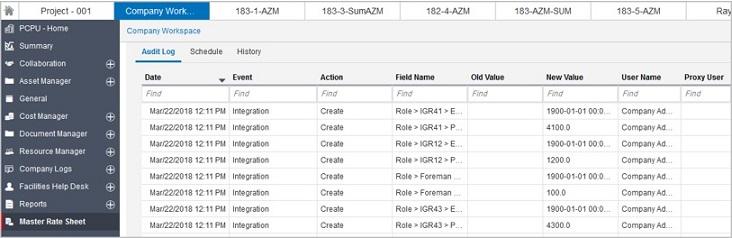

- Audit Log
- Schedule
- History
The Audit Log tab tracks all changes made inside the rate sheet.

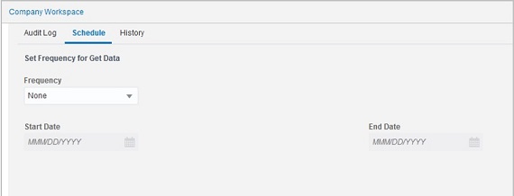

The Schedule tab allows you to set the frequency of automatically running the Get Data synchronization at daily, weekly, monthly or quarterly intervals between the specified start and end dates. Possible values in the Status field are:
- Running
- Completed

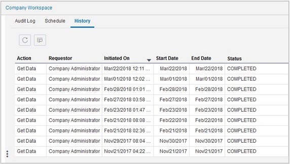

- Failed
The History tab captures information about manual/synchronization (schedule get data) job. The toolbar has Refresh and Find of Page functions. When you click Refresh, Unifier refreshes the History. This enables you to track the status of an ongoing synchronization. For example, when you click Get Data, and switch to the History tab, and you see new record with "RUNNING" (sometimes empty), then click Refresh to see the status changed to "Completed," if the job is done.
