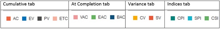

The middle section of the EVA sheet contains a Dynamic Data Table.
The headings for the dynamic data table are as follows, depending on the graph type:
The other headings may include:
The middle section of the EVA sheet contains the following tabs:
Depending on the tab that you select, you get the pertinent graph.
Curve Picker: Filter curves you want to view by selecting or clearing the colored boxes in the legend.
