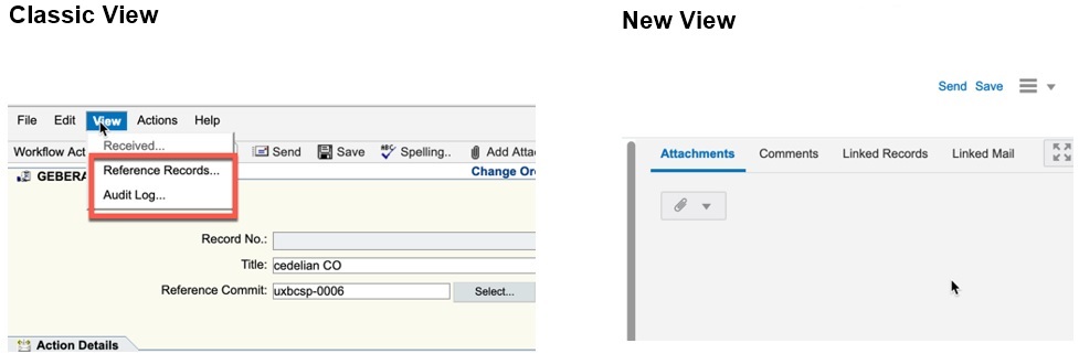

In a workflow business process, at any given step of a business process record, only those options (both tabs and menu) that are applicable to the given step will be displayed. For example, in the Classic View the Reference Records and Audit Log options were seen in the creation stage (although not applicable to the creation step). In the Standard View, these options are not displayed, as shown below:
Reference Records and Audit Log Become Hidden

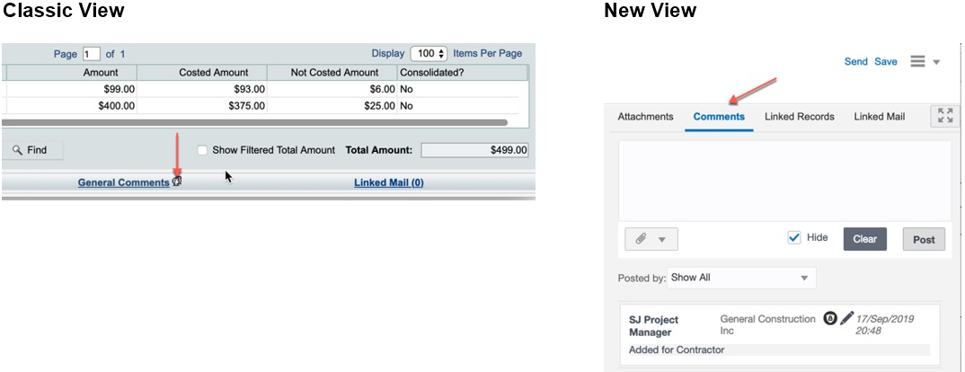

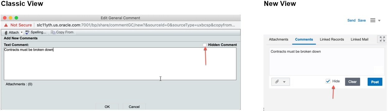

In the Standard View of both the workflow and non-workflow business processes, when you add a comment, by default the checkbox of Hide is selected, as shown below. This means that a comment is hidden by default and if you want your comment to be viewed by everyone, then you must deselect this option.
Hidden Comment Becomes Hide

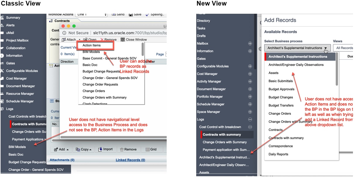

In the Standard View, when you add Linked Records to a workflow or non-workflow business process record, the list of the business processes displayed will be based on your (the user's) node access (items on left-hand Navigation screen). For example, if you do not have access (for example, view permission) to a certain node (sub-node) under the Logs, then that node (in this case a BP record) will not appear under the Logs. As a result, you cannot add the BP record as a linked record because you do not have permission, as shown below:
Action Items Becomes Hidden

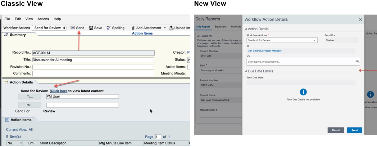

In the Standard View, the workflow details are displayed after you click Send. When the workflow details are displayed, the data validations, filtering of assignees (if applicable), and so forth, have already been completed.
Send Shows Workflow Details

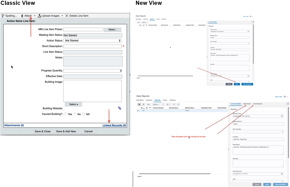

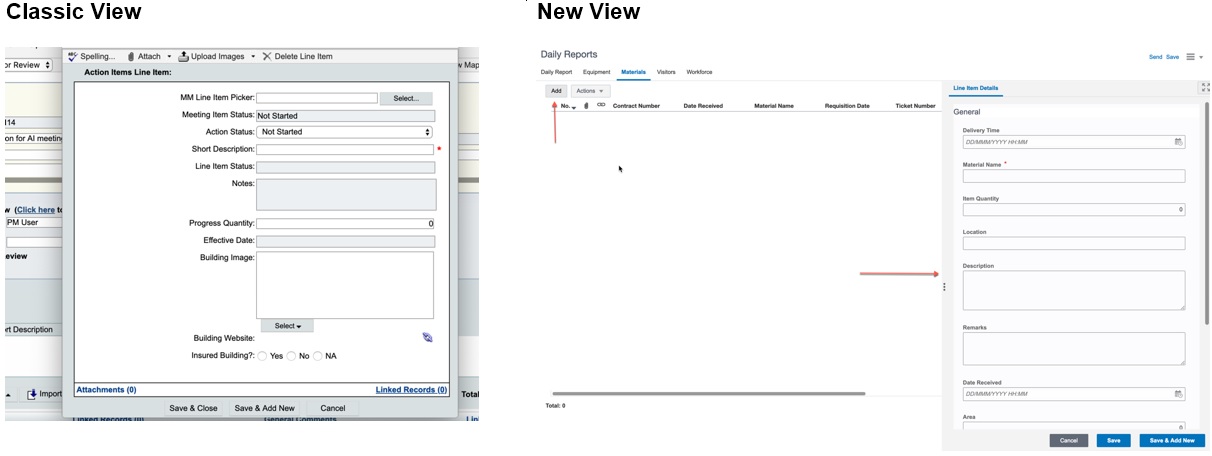

In the Standard View, the line item forms are no longer displayed as pop-ups. Instead, the line item detail form (Line Items Details) opens on the right-side of the line item list, as shown below:
Line Item Forms Open on Right Side of Line Item List
In the Standard View, for a line item, attachments and linked records can only be added after you save the line item, as shown below:
Attach And Link Records For Line Items After Saving

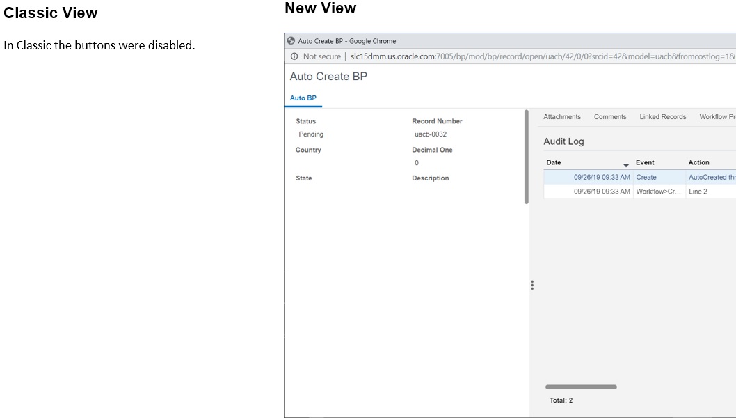

In the Standard View, for auto-created records (Auto Create BP) that are in Initiation Step, but the job is not yet complete, the accept and decline actions will not be displayed, as shown below:
Auto Create BP In Initiation Step

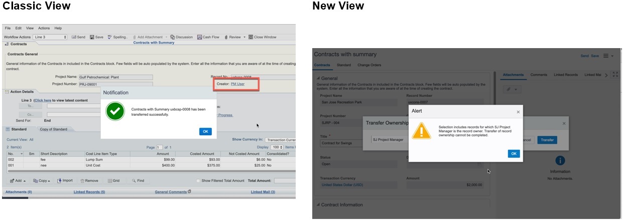

In the Standard View, you cannot transfer ownership if the selected user is the record owner, as shown below:
Cannot Transfer Ownership When Selected User Is Record Owner

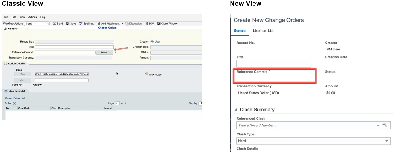

In the Classic View of Change Commit BP, if the Reference Commit field is marked as read-only, in the design (uDesigner), then in the Standard View the Reference Commit field will be rendered as a read-only data element, as shown below:
Note: Prior to this improvement, in the Classic View, this data element had an exception, wherein even if the field was marked as read-only, at runtime, the field would have been enabled.
Reference Commit Rendered As Read-Only Data Element

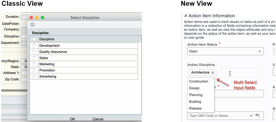

In the Standard View, fields that are multi-select-input data definition type do not support selection of multiple values in one attempt, as shown below:
Note: This is a technology limitation at this point of time.
Multi-Select-Input Data Not Supporting Multiple Values

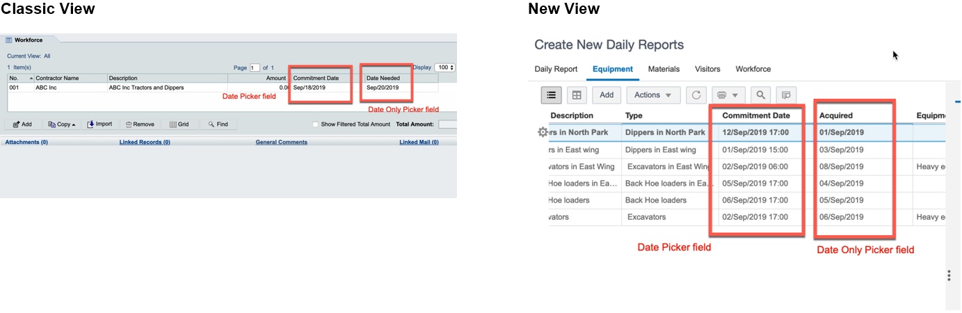

In the Standard View, if a Date Picker field has been added to the Line Item List, then the value displayed will include both the Date and the Time, as shown below:
Note: In the Classic View, the value displayed only included the Date and not the Time.
Date Picker Field Displays Both Date And Time

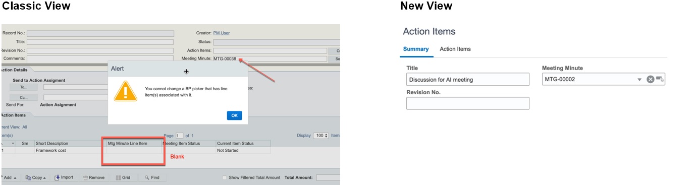

In the Standard View, you can change the BP picker field value (referenced by a Line Item Picker field) in a line item. The BP picker field value cannot be changed if the Line Item Picker field has a line item reference in the field, as shown below:
Note: In the Classic View, you could not change the BP picker field value even if the Line Item Picker field in the line item did not have a value.
BP Picker Field Value Can Change In A Line Item

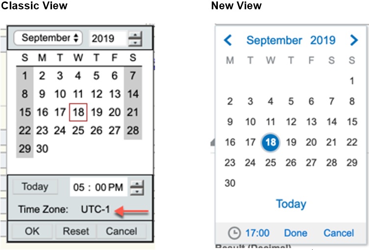

In the Standard View, the Date Picker controls will not have the Time Zone information, as shown below:
Date Picker Has No Time Zone Information

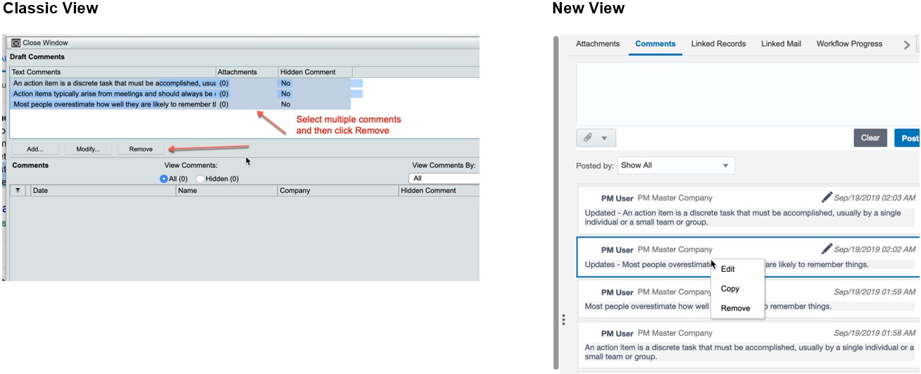

In the Standard View, you cannot delete multiple draft comments (from the Comments tab), as shown below:
Multiple Draft Comments Cannot Be Deleted

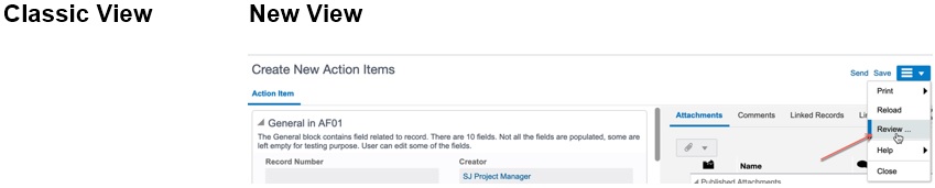

In the Standard View, the Document Review option is present at the time of creating the record, unlike Classic View where the option is seen only after creating the record, as shown below:
Document Review Option Present When Creating The Record

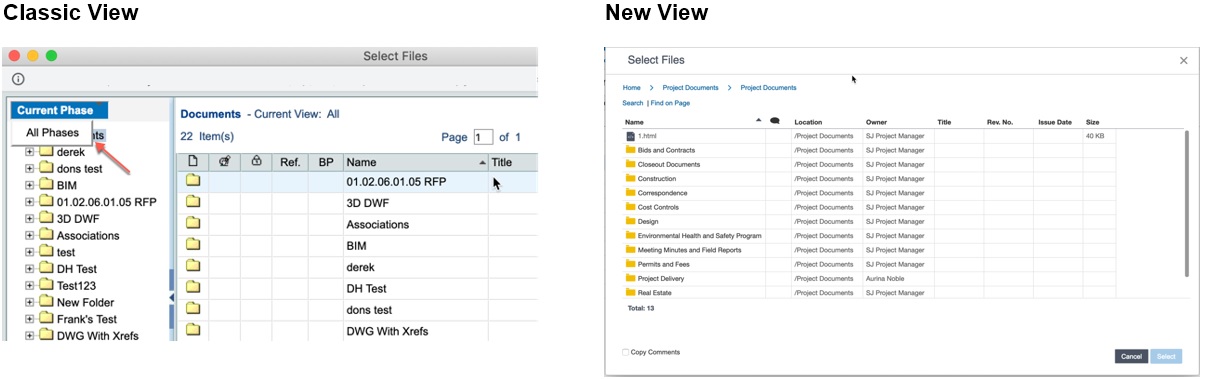

In the Standard View, the document management picker (displayed when adding attachments from Unifier Document Manager) does not show phase selection, as shown below:
No Phase Selection Of Document Management Picker

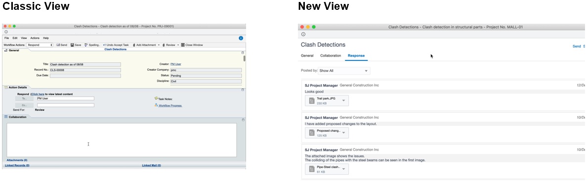

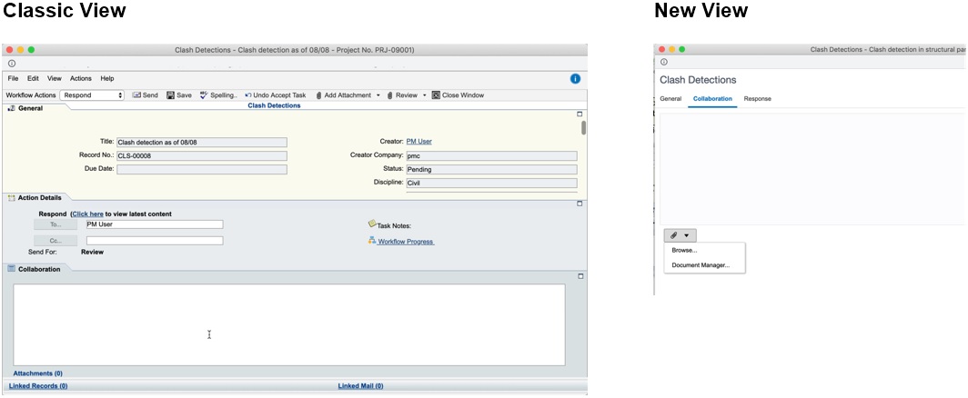

In the Standard View, for the Text-type business process, the way the comments are added and displayed has changed, as shown below:
Comments In Text-Type Business Processes Have Changed
Standard View, for the Text-type business process, you can view previous comments in the Response tab, as shown below:
Previous Comments In Response TabIn the

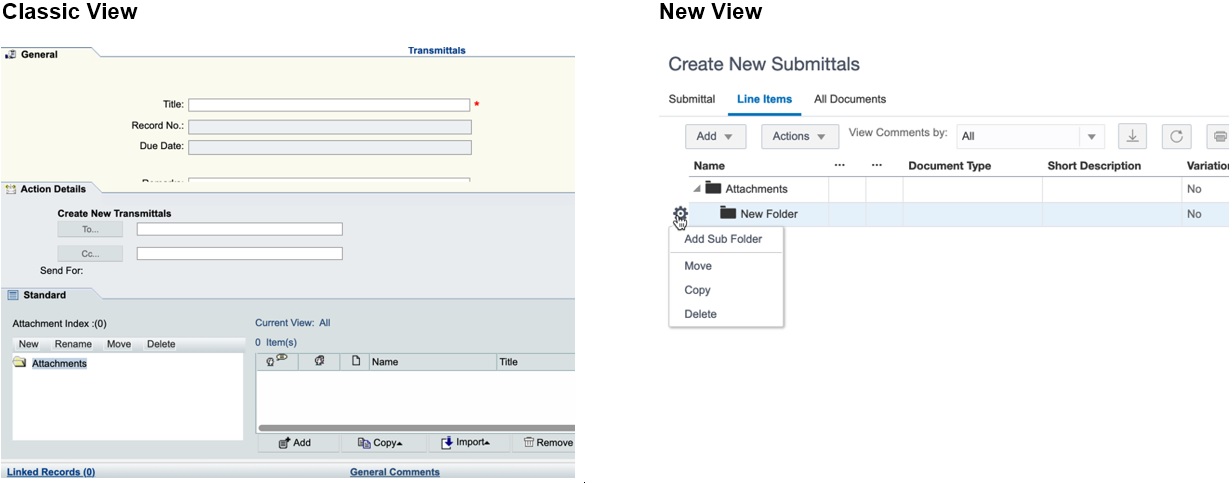

In the Standard View, for the Document-type business process, the steps to create folders and line items have changed, as shown below:
Creating Folders And Line Items Have Changed

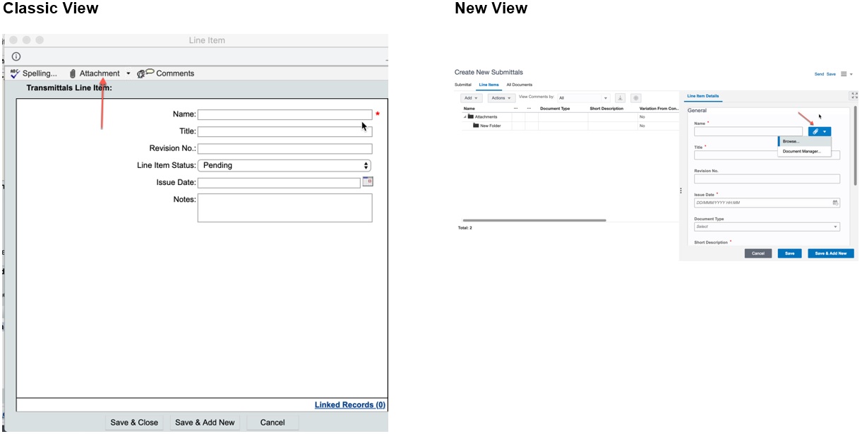

In the Standard View, for the Document-type business process, the steps to add an attachment to a line item has changed, as shown below:
Adding Attachments To A Line Item  Has Changed

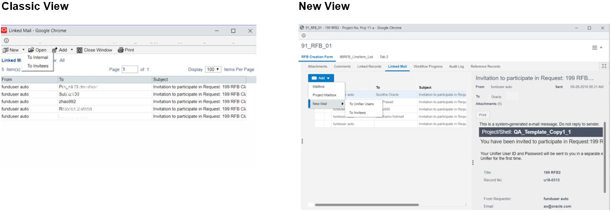

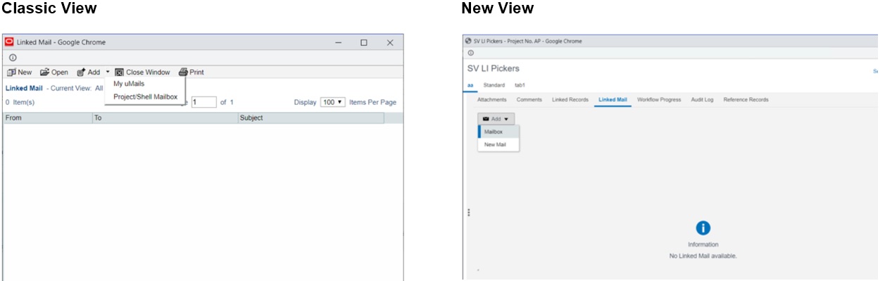

In the Standard View, in the Linked Mail tab, the Add drop-down list includes the options:
See below for details:
Add Drop-Down List in Linked Mail Has Mailbox And New Mail

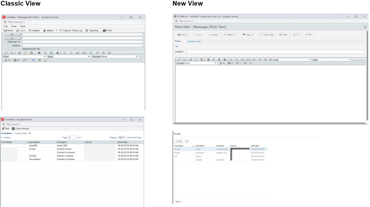

In the Standard View, in the Linked Mail tab of the RFB-type (Request for Bid) business process, you can send emails to Unifier users and bid invitees through Add > New Mail, as shown below:
Note: In the Classic view, you used the New menu option to send emails to Unifier users and bid invitees.
Send E-mails To Users and Bid Invitees Through Linked Mail
In the Standard View, for the RFB-type business process, when sending email to invitees, you can click the Tohyperlink to access the list of all available invitees, as shown below:
Note: In the Classic View, you clicked the Tooption to access the list of all available invitees.
Access List Of Invitees Through To Hyperlink

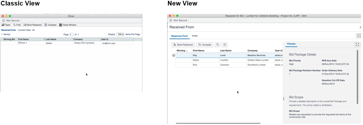

In the Standard View, for the RFB-type business process, after a bid is closed, the show bid screen (Preview) has been enhanced, as shown below:
Show Bid Screen Has Changed

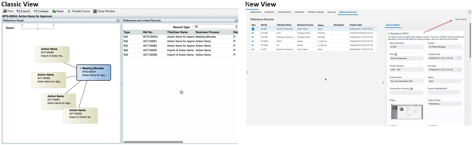

In the Standard View of both the workflow and non-workflow business processes, the graphical diagram and the list view (while viewing of reference records in the Reference Records tab) have been enhanced, as shown:
Graphical Diagram And List View Have Changed

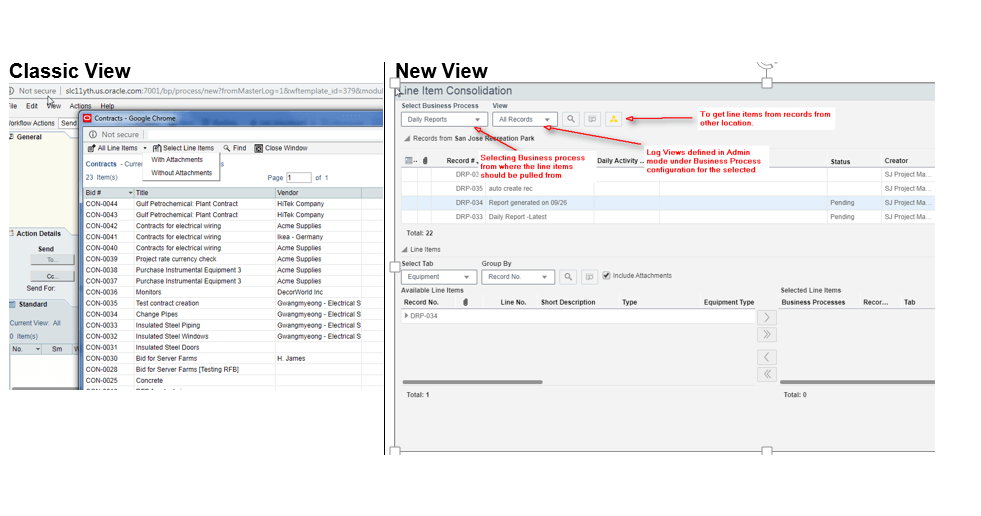

In the Standard View, the Line Item Consolidation window has been enhanced, as shown below:
Line Item Consolidation Window Has Changed
