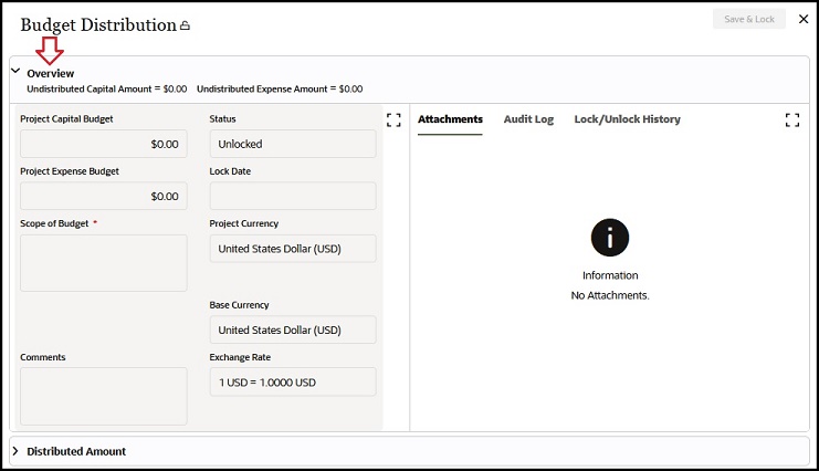

Working with Budget Distribution Overview
When you click Budget Distribution from the Menu Options, as shown in the image below, the Overview block provides two sets of information within two panes. For example, the left pane provides information about the project budget capital, expense, and scope, and the right pane provides properties information within the following tabs:
- Attachments tab
Contains any available files that have been attached to the budget as supporting record.
- Audit Log tab
Lists all of the actions taken on the budget.
- Lock/Unlock History tab
Provides a history regarding the times that the budget has been locked or unlocked, which includes date, time, explanation, and user name.

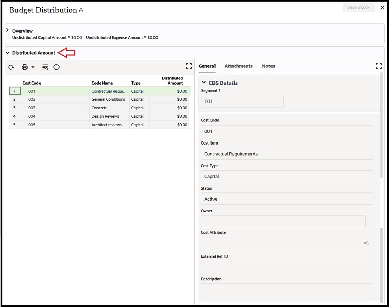

Working with Budget Distribution Distributed Amount
When you click Budget Distribution from the Menu Options, as shown in the image below, the Distribution Amount block shows cost code details and properties. The Distribution Amount block is divided into two panes:
- The left pane lists the cost codes and the cost codes information related to the budget distribution.
- The right pane is the properties pane which contains the information to a selected cost code that is listed in the left pane.
These properties pane has the following tabs:
General tab
When you select a cost code from the left pane, this tab shows the CBS details for that cost code. All the fields are read-only.
Attachments tab
When you select a cost code from the left pane, this tab lists any files that are attached to that cost code.
Notes tab
When you select a cost code from the left pane, this tab lists any notes related to that cost code.
Use the Distribution Amount block toolbar options to refresh, print, find, or collapse-expand the groups of cost codes listed (if any).
