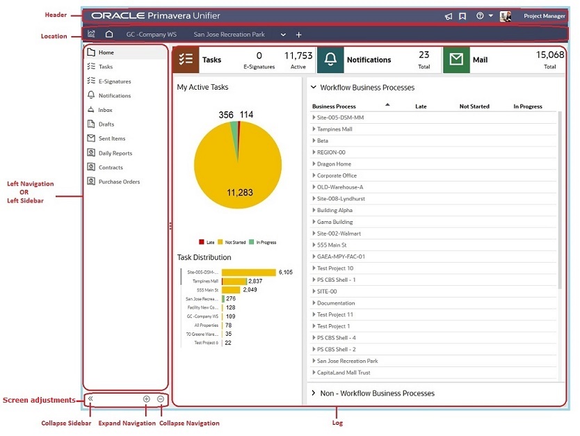

The Unifier user interface has both static and dynamic elements.
The following image displays the static elements of the Unifier user interface, and the explanation for each static element follows.

The header section of the interface contains the following elements, from left to right:
You may see the Upload Status icon ( a circle with an up arrow) appear next to the Announcements icon. This happens when there are documents pending to be uploaded. In general, when you go to the Document Manager node (for example, Company Workspace or Administration tabs > Document Manager where you can upload multiple documents), you can see the Upload Status icon on top. The color of this icon changes depending on the upload status. You can click Clear to remove this icon.

The location section of the interface contains the following elements, from left to right:
Note: One page or tab must always be present.

The left Navigation (or left Sidebar, or Navigation) lists all of the nodes (or modules) that are available for a company, program, shell, or project.
Note: Your Navigator setup may differ, but the basic functionality will be the same.
Your company administrator can configure the User mode Navigator (Company Workspace > Admin mode > Configuration > User Mode Navigator) to better suit the company business needs.

Every module, feature, and record in Unifier can be accessed by way of the Navigator, which is always available in the left-hand pane of the Unifier screen. The Navigator is similar to a folder system, much like a network drive. Each feature is stored in its own "node," similar to a folder. Each node is controlled by permissions. If you do not see a feature in the Navigator, contact your project or shell Administrator or Company Administrator to verify that you have been assigned the proper access permissions.
As you access different nodes (modules) on the left-hand Navigator, the Navigator remains available on the left of the screen, while the content frame on the right changes.

The screen adjustments section of the interface contains the following elements, from left to right:
Use the Expand Navigation or Collapse Navigation icons at the bottom of the Navigator pane to expand or collapse all the nodes (modules) in the Navigator.

This right pane displays all of the information pertaining to the nodes (or modules) that are available for a company, program, shell, or project. The right-hand pane houses the logs. Additional functions are available from the options and links at various parts of the logs.
On top, below the company, shell, and project tabs, the locator links (breadcrumbs) are displayed. The locator links:
Click the drop-down arrow of a locator link (breadcrumb) to reveal the direct children or sub-shells of that location.
Even if you do not have permission to access a shell, the shell name appears in the breadcrumb trail.
