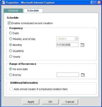

To define a BP creation schedule
  1. In User Mode, navigate to the log of the business process for which to edit the template.
  2. Click the File menu and choose Template. The Template List window opens.
  3. Select a template and click Properties. The Properties window opens.
  4. Click the Schedule tab.
  5. Complete the Schedule tab as described in the following section.
  6. Click OK. The schedule is active as long as the template status is Complete.
In this field
Do this
Enable scheduled record creation
Select this checkbox if you want to enable automatic record creation based on the schedule defined below.
Frequency
The frequency determines how often the new records are created from the template. The options are:
Daily
Weekly (select the day of the week)
Monthly (select the day of the month)
Quarterly (runs on the last day of the calendar quarter)
Yearly (runs on the last day of the calendar year)
All scheduled record creation is performed at 11:59:59 PM (PST).
Range of Recurrence
Choose one of the options:
No end date (runs until changed or schedule is disabled)
End by (select an end date)
Auto-email creator if scheduled creation fails
Select this option if you want the template owner or creator to receive email notification if the scheduled creation fails. The email will contain location information so that the recipient can see where the auto-creation originated, and where it failed.
