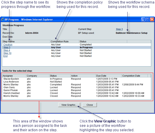

    Unifier displays the BP Progress window, showing the step the record is currently on.
    Example of progress tracking for a workflow
    You can use this window to display every step in the workflow schema, the action of the step, the assignees (and those cc’d) on the task, and the status of the task at each assignee’s action.
  3. Click the name of the step you want to audit.
    Unifier displays the history of each assignee’s action on that step and the step’s status at that time. The actions are shown in reverse chronological order by Due Date (i.e., the latest due date is at the top of the list).
