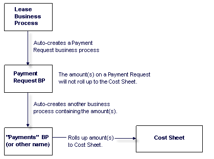

Lease business processes are typically used to auto-create invoices (if you are the landlord) or payment requests (if you are the lessee). For example, a lease business process with a payment schedule can use auto-creation to generate payment request records at appropriate days in advance of the payment due date to be routed for approval.
Note: You receive a single auto-created line item based on the defined grouping criteria.
For cost purposes, these invoices/payment requests do not roll up amounts to the Cost Sheet. To roll up these amounts, the invoice/payment request should, in turn, auto-create another business process for the purpose of rolling up the amount(s) to the Cost Sheet.
