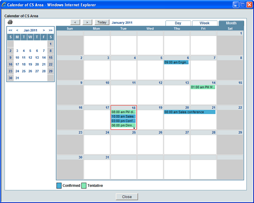

  2. On the toolbar, click the Calendar button. The Calendar window opens.
    By default, the calendar opens in the "Month" view. You can change this to a day or week view if you want using the tabs at the top of the calendar. If there are more reservations than are visible on any day, click the down arrow at the bottom of the day cell to see the rest of the reservations.
    The calendar shows confirmed and tentative reservations in color. The current day is outlined in red.

To view all reserved objects in a log
If you want to see all the reserved objects in a log, click the Calendar button above the log. Unifier displays a calendar showing all the reserved objects from that log. The Calendar button will not appear above the log unless there are calendar-enabled objects in the log.
