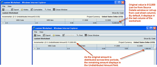

  4. For each applicable CBS code, change the value in the last column to the correct distribution amount and press Enter. The rest of the original cost amount displays in the Undistributed Amount field at the top of the worksheet. If you distribute a total amount that exceeds the original total, the Undistributed Amount field displays a negative amount.
    For example, if the original value is $12,000 in the last column (either added manually in the Source Details window or rolled up from a cost column), and the distribution should be $1,000 per month over a 12 month period, then enter $1000 in the last column. The remaining $11,000 will display in the Undistributed Amount field. As you enter $1000 in each of the other month columns, this Undistributed Amount will decrease.
