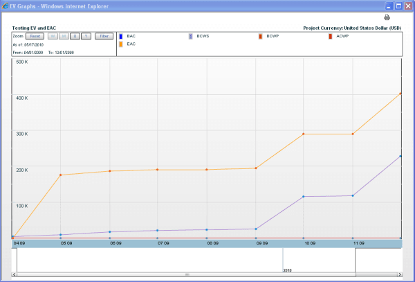

To change the zoom level of the graph
Click Zoom and choose Week (W), Month (M), Quarter (Q), or Year (Y). This will change the plotting of the graph display (not the data calculations), and enable you to view data by time period. Graphs using the Week (W) and Month (M) zoom levels are displayed using the Date Format set in your User Preferences. Refer to Unifier General User Guide for details on setting the date format in User Preferences. Graphs using the Quarter (Q) or Year (Y) are displayed using the Time Scale Format set in the EV Properties General tab.
Note: Some earned value calculations can lead to a negative number. These results are shown on the graphs.
The zoom level that you choose works with the time period by which data is captured. For example, if you are capturing data by the month, and select the zoom level Quarter (Q), the graph will display three months of data. If you select the zoom level Year (y), the graph will show 12 months of data.
For example:
You can create your own time scale by using the scale slider bar at the bottom of the graph. Drag to the right or left to experiment with the time scale.
