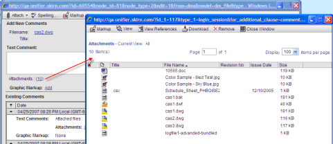

  1. In the Add New Comments portion of the View Comments window, click the link next to Attachments. The Attachments window opens.
  2. Select the file to be removed and click Remove.
To mark up a file attached to a comment
  1. In the Add New Comments portion of the View Comments window, click the link next to Attachments. The Attachments window opens (see below.)
  2. Select the file and click Markup. Follow the procedures for marking up a document.
