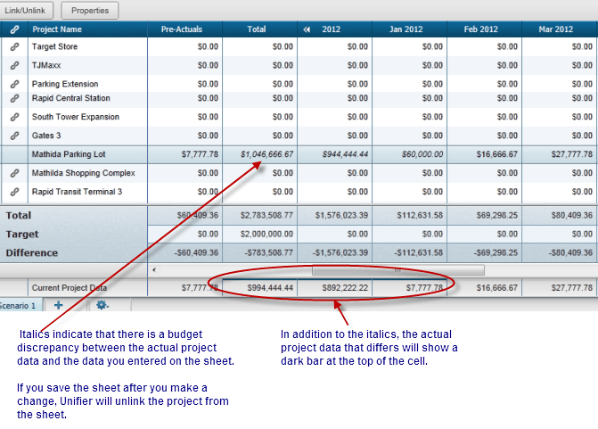

    You can also unlink a project by editing any cell in the row. Once you start editing, Unifier will automatically unlink the project from the project data.
    If an unlinked project shows a discrepancy between the actual project data and the data you entered on the sheet, Unifier will display the numbers in italics and flag the actual cell data that differs with a dark bar.
