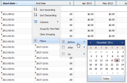

To filter information using a date column
Click the arrow beside the column name and choose Filters.
