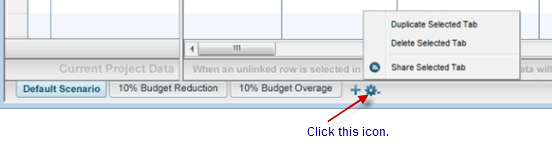

  1. At the bottom of the scenario sheet window, select the tab containing the scenario you want to share.
  2. Click the manage scenarios icon and choose Share Selected Tab.
  3. Click Save All.
Unifier visually marks the scenario tab with a "shared" icon and makes the scenario numbers visible on the portfolio budget cash flow curve for the project manager to see.

  1. At the bottom of the scenario sheet window, select the tab containing the scenario you want to stop sharing.
  2. Click the manage scenarios icon and choose Stop Sharing Selected Tab.
  3. Click Save All.
