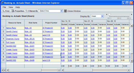

The sheet shows all booked resources, along with their roles and the projects/shells they are booked in. It shows both the booked hours and the actual hours the resources worked on the project/shell. The sheet does not show non-project hours.
To see details
To see a resource’s booking details, click the hyperlinked hours in the Booked column. Unifier opens a Cell Detail window showing the booking details for the resource. To see details on a resource’s actual hours worked, click the hyperlinked hours in the Actuals column. Unifier opens a Cell Detail window showing the actuals for the resource.
