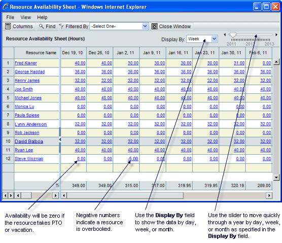

Resource Availability sheet
The Resource Availability Sheet resides at the company level. This sheet shows the current availability of each resource across all projects/shells. A resource’s availability equals the resource’s total capacity (hours available), minus the total bookings across the projects/shells, and minus the non-project times specified. The sheet also shows over-bookings and zero hours where the resource is not available due to PTO, vacation, or administrative duties.
Unifier automatically adds the Resource Name column to the sheet; you cannot move this column. Unifier adds rows to the sheet whenever a Resource Booking business process is submitted. You can manually add columns directly to the sheet to show more information. You can also modify data manually on the sheet.

In the company-level Resource Sheets log, select Availability Sheet and click Open.

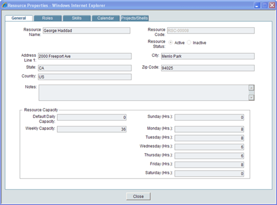

To view a resource’s available hours and other information
Click the resource’s name. Unifier opens a read-only copy of the resource’s properties. These can include the resource’s address and phone number. This window will also show the resource’s capacity of work hours per week. Depending on the design of the Resource Attribute form, this window might also show a breakdown (as in the example below) of the resource’s hourly working capacity by day.

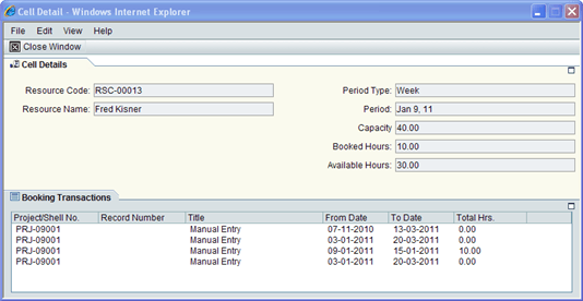

To view booking details
You can drill down to an individual resource to see a read-only copy of the booking information. To do so, click on the value in any date column. Unifier displays the cell details.
The cell details show the following information:
Resource Code
The code assigned to the resource
Resource Name
The name of the resource.
Period Type
The period of availability being displayed. (This reflects what the Display By choice was.)
Period
The time the data on this window covers (day, week ending date, month ending date).
Capacity
The hours the resource is available during the period.
Booked Hours
The number of hours the resource is booked during this period.
Available Hours
The number of available hours the resource has left for booking during this period.
Transactions
The booking transactions that are reflected in the data in this window.
Project/Shell No. shows the number of the project/shell for which the resource is booked.
Record Number shows the number of the business process record (unless the entry was manual).
Title shows the title of the business process. This column will show "Manual Entry" for any hours that were manually entered on the sheet.
From Date shows the beginning date of the resource’s period of availability.
To Date shows the end date of the resource’s period of availability.
Total Hrs shows the total number of hours the resource is available during the period.
