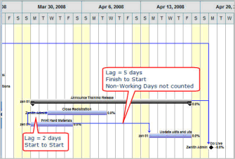

Here you can add dependencies between the current activity and other activities from the schedule sheet. You can select another activity on the schedule sheet, determine the relationship, (e.g. Finish to Start, Start to Finish, Start to Start, or Finish to Finish), and add a Lag.

    • Finish to Start: the dependency must finish before the Activity can start.
    • Start to Finish: the dependency must start before the Activity can finish.
    • Start to Start: the dependency must start before the Activity can start.
    • Finish to Finish: the dependency must finish before the Activity can finish.
  4. In the Lag field, enter the number of days for a gap or overlap between the selected activity and the current activity. A positive lag indicates a gap. A negative number indicates an overlap.
