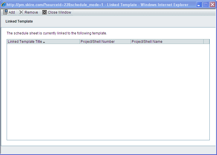

To view the linked template for a linked schedule sheet
  1. Navigate to the schedule sheet log.
  2. Select a schedule sheet that is linked to a schedule sheet template.
  3. Choose View > Linked Template. The Linked Template window opens.
  4. Click Close Window when you are done viewing the linked templates.
