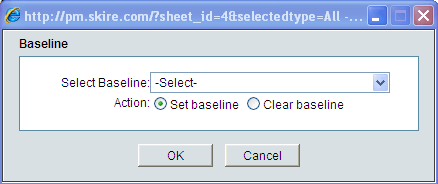

  3. Select Baseline > All to apply the baseline to all of the projects and shells listing in the Activity Sheet. Select Baseline > Selected to select one or more project or shell rows. The Set Baseline window opens.
  4. Select the baseline to set. The Set baseline radio button is selected by default. Only baselines that have been designed in uDesigner are available.
  5. Click OK. The values from the start, finish, and duration elements are copied into the corresponding baseline elements. If the baseline elements contain data, you will receive a warning that the baseline will be overwritten. You can choose whether to override the data. The Confirmation window opens.
  6. Click Yes to confirm the baseline settings. The Processing Status window opens. After the system processes the baselines, you will see a check mark next to the rows in the Activity Sheet that indicate the baseline was set successfully. If the baseline was not set, failed rows in the sheet are marked with an X.

  2. Choose Edit > Baseline. The Set Baseline window opens.
  3. Select the baseline you want to clear.
  4. Select the Clear baseline radio button.
  5. Click OK. The Confirmation window opens. Click Yes to confirm the cleared baselines. The Processing Status window opens. After the system processes the baselines, you will see a check mark next to the rows in the Activity Sheet that indicate the baseline was cleared successfully. If the baseline was not cleared, failed rows in the sheet are marked with an X.
