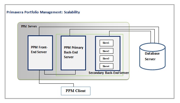

The initial or XSmall deployment configuration for OPPM is shown below:
For Small deployments, include a secondary back-end server. This is suggested as a result of testing with the data set described in Appendix A.

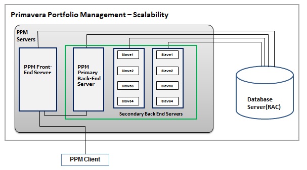

You can manage increasing complexity by adding additional servers (secondary back-end and front-end servers). For database servers, the number of nodes in RAC implementation must be increased, as shown in the figure below:
Note: Each back-end application server adds additional capacity to process the Action Queue. Add as many back-end application servers as necessary to process the Action Queue within the time required by business needs.
