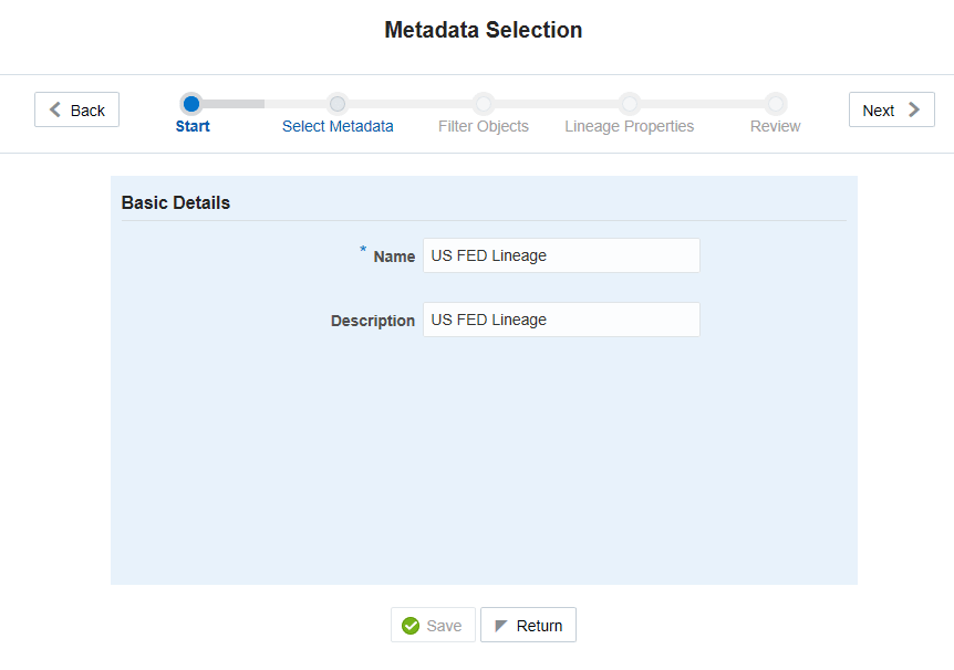

11. Provide the Name and Description for the new template on the Template Definition page.
Figure 133: Metadata Selection

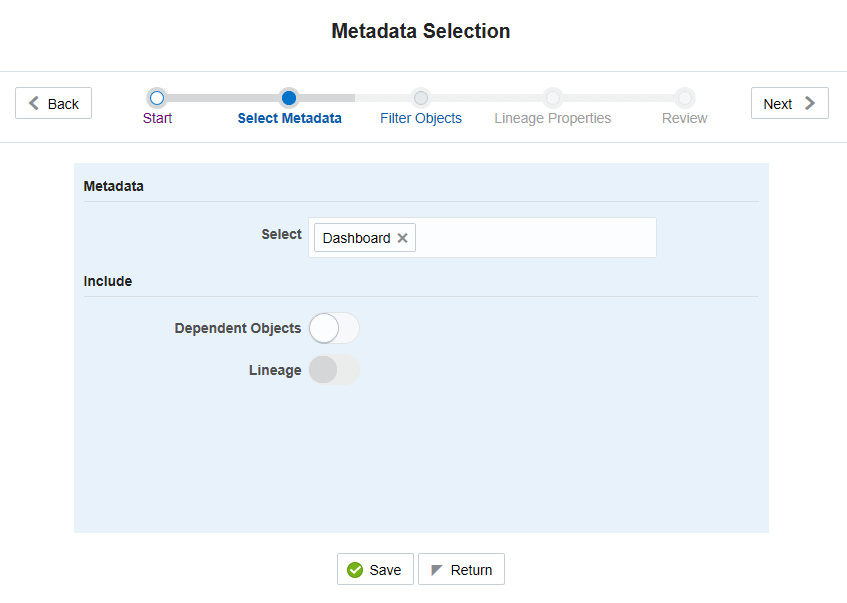

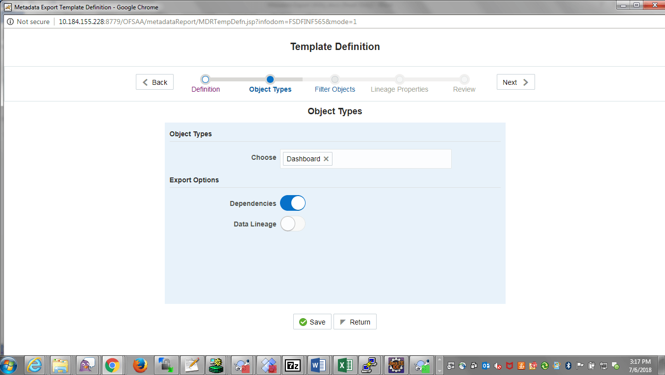

12. Select the desired object from the Object Type drop-down to be exported.
13. The individual report generates only the basic properties of the object selected, that is, name and description. The relational report generates detailed information up to the Entities level if Dependencies is chosen, and up to the Staging Columns level, if Data Lineage is selected along with Dependencies.
14. Dependencies: The metadata object is dependent on several other metadata objects. Metadata object is also used (that is, consumed) in several other metadata objects. Dependency or usage tree can be of any depth. For example, a rule can be dependent on a hierarchy, business processor, and dataset. Further, each of these metadata objects can be dependent on other metadata objects. Metadata Export Utility exports all the dependent or used metadata objects for all paths in the dependency or usage tree if this option is selected.
15. Lineage: Data is loaded from source systems to staging and then moved across to processing/reporting. Lineage traces the data element as it moves across different layers of OFSAA: staging, processing, and reporting. Metadata Export Utility exports the lineage of each of the reporting area data element that is identified by dependencies.
16. For Individual Report: In the Export Options, do not select Dependencies or Data Lineage.
Figure 134: Metadata Selection

18. For Relational Report: In the Export Options, select Dependencies.
Figure 136: Template Definition

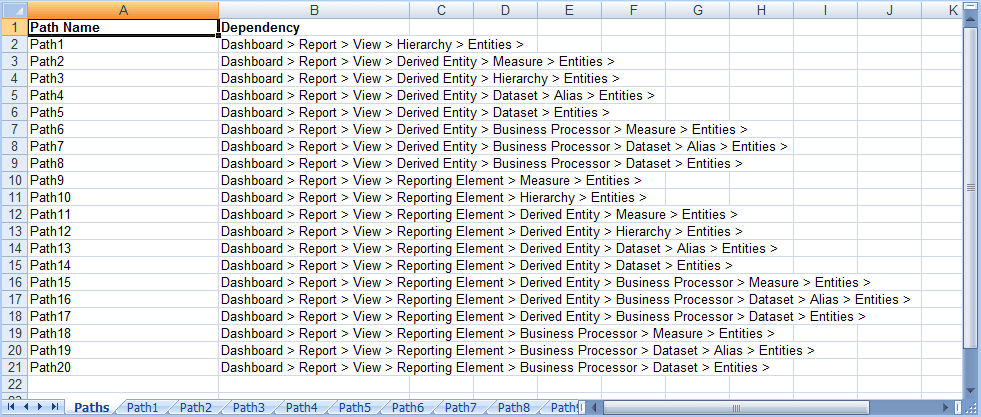

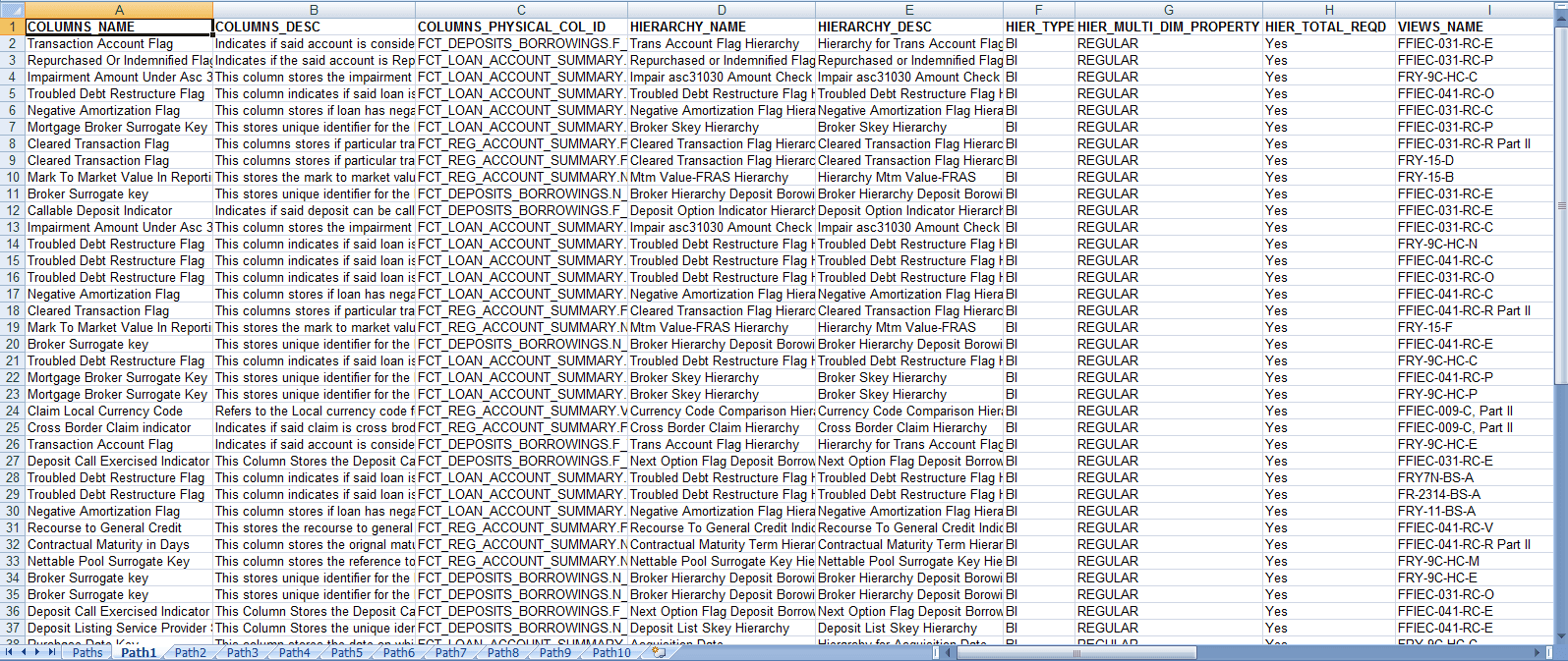

20. The first sheet shows the different Paths and their Dependencies up to the Entities level. Select the required Path sheet at the bottom to view the dependencies.
Each path tells how the dependency/usage is derived from dashboard to entity or vice versa involving various OFSAA object types like Derived Entity, Hierarchies, Datasets, Measures, and so on.
21. These paths are generated by the system using data already published in MDB dependency tables as part of the OFSAA MDB object publish.
22. For every dependent object type displayed in each path sheet, the following columns appear:
— Object type name
— Object type description
— One of many Object-specific properties (optional)
23. For example, In Path1, Dashboard is the first Object type, the dependencies generated are Dashboard Name, Dashboard Description, and Dashboard properties: Dashboard Country, Dashboard Regulator, and so on. Similarly, Report is the next Object type in Path1 and the dependencies generated are Report Name, Report Description, Views Name, Views Description, View Display Format, and so on. It continues followed by Hierarchy Objects name, description, and properties up to the Entities level.

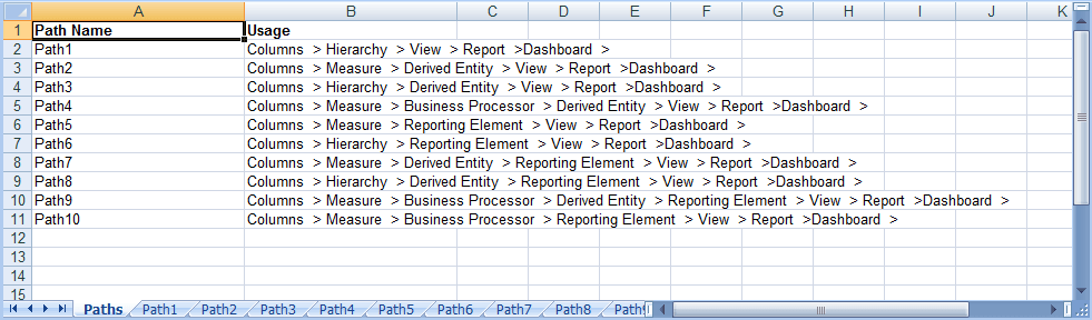

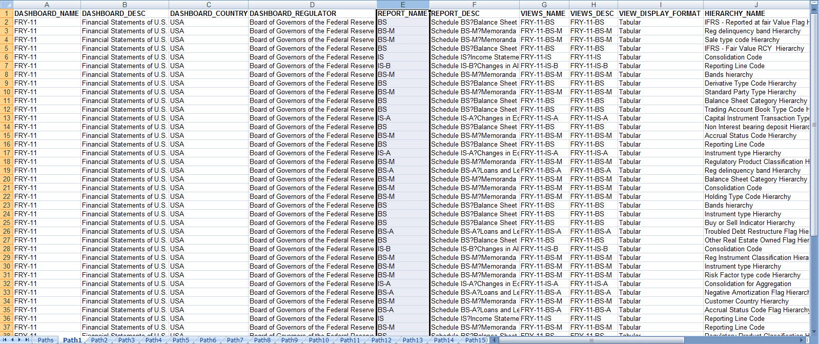

24. The Usage sample report (generated by default when Dependencies is selected) is as follows:
Figure 139: Exported Sample Report
NOTE |
The first sheet shows the different Paths and their Usage up to the Dashboard level. Select the required Path sheet at the bottom to view the Usage. |
Figure 140: Exported Sample Report

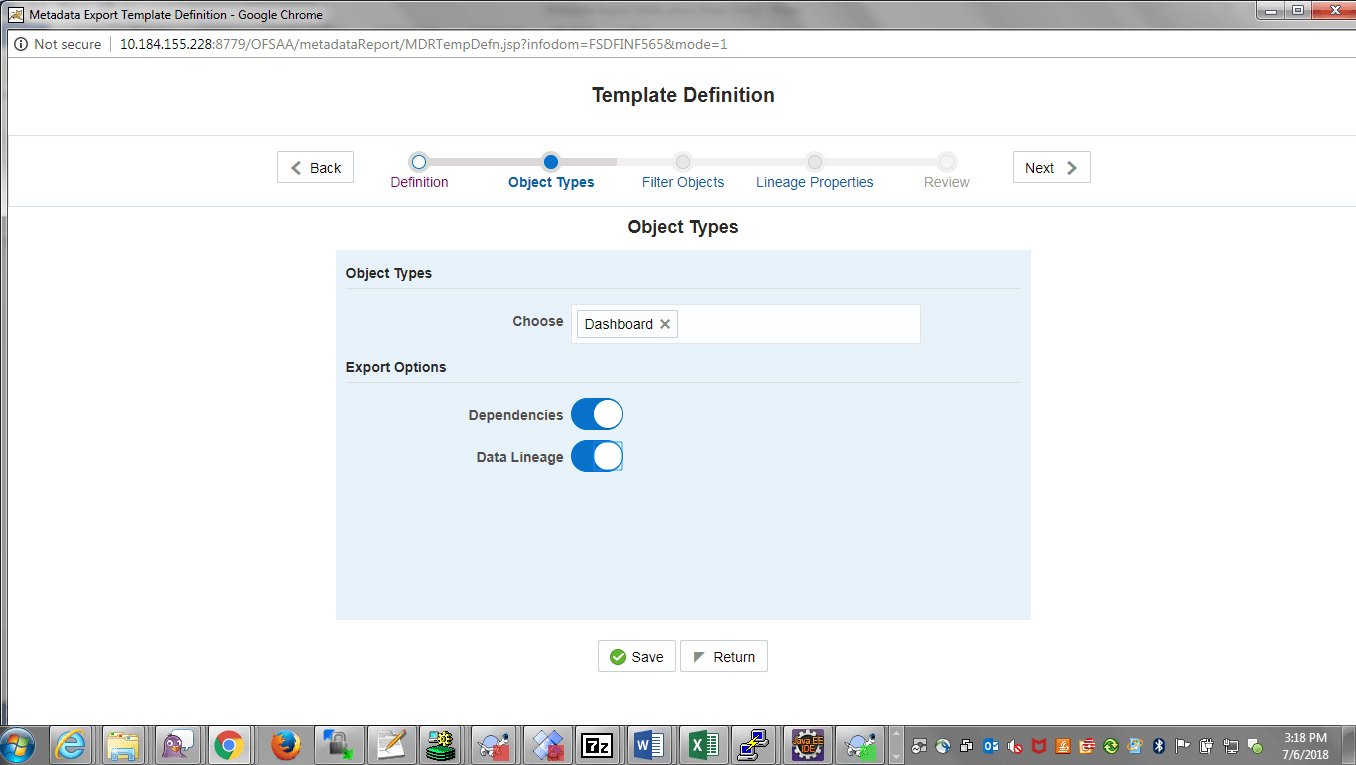

25. Select Data Lineage in Template Definition à Choose Object Type to export the lineage details up to the Staging Columns level.
NOTE |
Data Lineage can be selected only if you have opted for the Dependencies feature. The minimum memory settings to run lineage reports must be export JAVA_OPTS="-Xms1024m -Xmx8192m". |
Figure 141: Template Definition

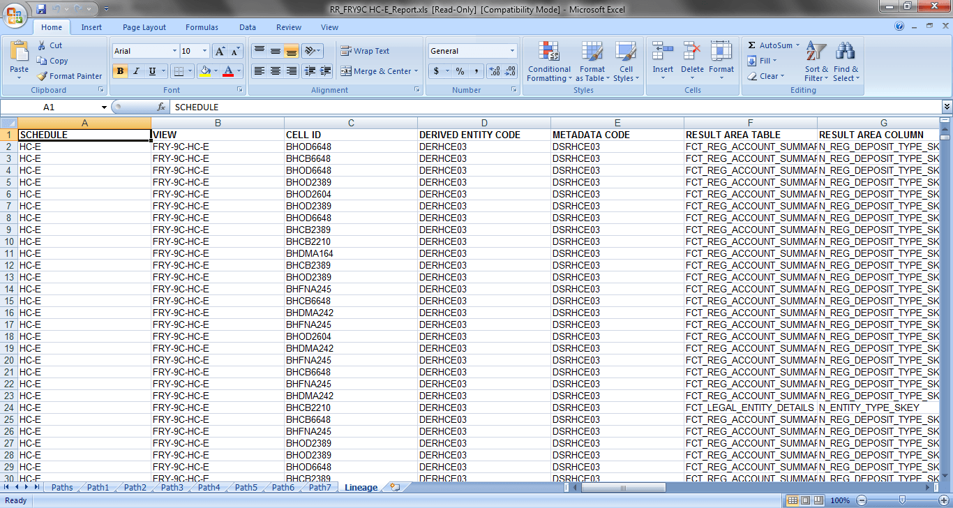

26. Data Lineage is generated as a separate sheet in the generated Relational report along with the Dependencies. Select the Lineage sheet to view the Data Lineage (up to Staging column level).
Figure 142: Exported Sample Report

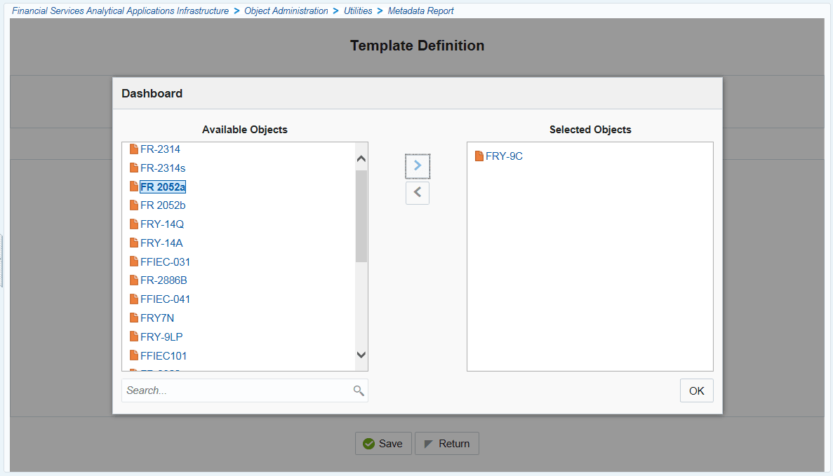

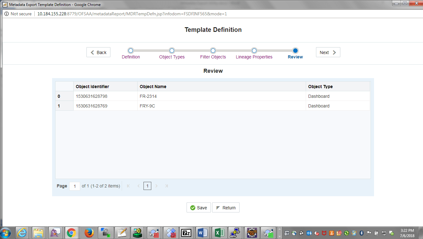

27. Select Filter Objects to see the selected objects.
Figure 143: Template Definition
28. Select one Filter Object from the Available Objects and Click
to add a Selected Object. Select one Selected Object from the Available Objects and click
to remove a Filter Object.
Figure 144: Dashboard
29. When the object list is huge, use the Search option as shown above. Type first three letters of the Filter Object name and the relevant Filter Objects appear.
NOTE |
You can type the complete Filter Object name to select and add to the Selected Objects. |
Figure 145: Dashboard

Figure 146: Template Definition
32. Review the Template Definition and click Save.
Figure 147: Template Definition
33. Click Return to go to the Summary page.

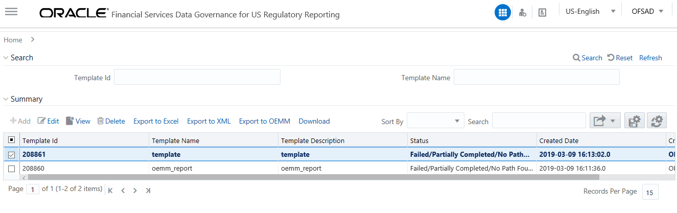

34. Select a template in the Template List in the Summary screen and click Export to Excel to export the desired objects in Excel Sheet format.
NOTE |
MDB Publish must be triggered before executing the Export to Excel option. |
35. The Report Generation function is an asynchronous action and to check the status of the export function, use the Refresh option in the Summary screen.
· For Excel Export, the following are the Status values:
§ Not Started: The Report Generation is yet to start, but the function has triggered the action in the background.
§ Ongoing: The Report Generation is started and in process.
§ Completed: The Report Generation is completed and ready to view or download.
§ Failed / Partially Completed / No Path Found: The Report Generation encountered an issue and the process is partially completed or failed.
r. The export logs are generated and placed in the path /Context_Name/logs/MDB.log.
Log files give the following information:
a) All Paths query
b) Query for each path and if data present for this path
c) Lineage query
d) Status of excel output creation
e) Exceptions and errors if any

38. Click the View icon to view the generated Metadata Report Templates excel report (after the export status shows as completed).
Figure 148: Metadata Report
